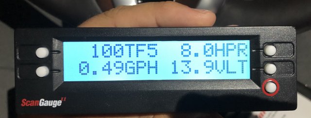

Thank you both for the recommendation, I ended up getting the ScanGuage II, and after going thru all of the transmission codes on their website and going thru 5-6 custom codes found that the very last one ended up working on the Palisade, here's the code for anyone who needs it:
  • Gauge
  • TXD 07E1222081
  • RXF C32200000000
  • RXD 3008
  • MTH 00090005FFD8
  • 4.22+ Required
Highest temp I had while towing was up to about 234F, a little high so if there's a transmission cooler option I would investigate it.
  • Gauge
  • TXD 07E1222081
  • RXF C32200000000
  • RXD 3008
  • MTH 00090005FFD8
  • 4.22+ Required
Where are you mounting that?
I mounted my ScanGauge on the dash immediately in front of me. I can see it over the steering wheel while hardly taking my eyes off the road. I usually have to set to monitor transmission fluid temperature, engine oil temperature, coolant temperature and battery voltage. Of course, one can monitor a dozen other parameters at any time by scrolling through the listings. I've had mine on three other cars ( 2 Mazda C-9s and a Honda Odyssey) and find it a useful tool.
