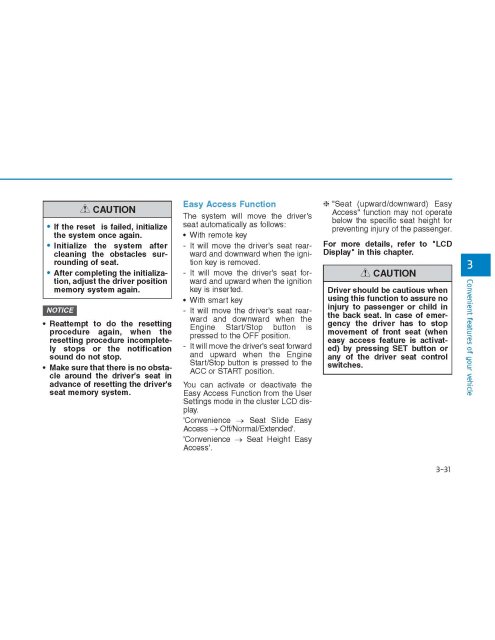

1. Is there a way to defeat the drivers seat from sliding back when shutting the car off?

Yes you can disable the Easy Access feature from the User Settings. I've attached the instructions. I have the non-digital dash, hopefully another owner can answer that part for you.
